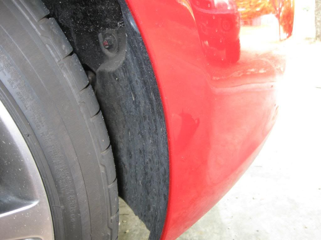

I then proceeded to weigh the complete right front fender liner to determine stock weight of each. The liner is about 4 lbs & I assume that the other side is relatively close to this weight. I noticed after removal that there is a canyon along the edge of the fender where the fenders are rolled back in.
This canyon looked to be an area where debris would collect & I decided that at least a portion of the liner needed to be reinstalled. So I trimmed the liners down to where they mainly covered that outer edge only & was able to reduce the weight down to 1.2 lbs per side, saving a total of 5.6 lbs. Below is a pic of the final product sitting atop my Matco rollaround toolbox. The left side of the liner is stock & the right side with the zig-zag is where I cut the liner.
Luckily when I removed the liner, I found a guide (curved line for rigidity) where to cut the fender liner to fill my needs. I used a pair of tin snips to do the trimming, after which I reinstalled to check fitment.

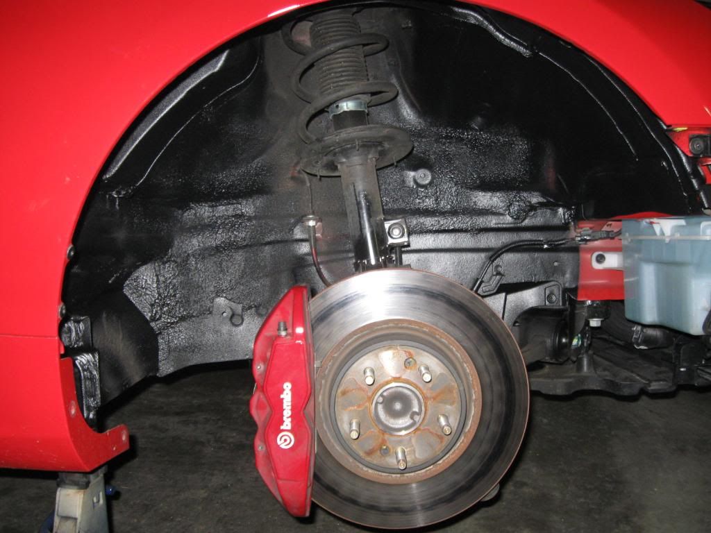

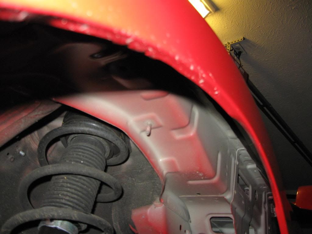

Now that these liners have been trimmed down, I noticed alot more red paint visible from lack of under-coating. So I decided to go ahead & do the under-coating while completing this fender liner mod.
To prep for undercoating, I just hung a shop fender cover from the top of the strut, allowing it to fall down over the Brembo caliper & taped a piece of card board in front of the bumper cover to protect from over spray.
In addition, I decided to spray the rear fender inners with under-coating as well since I've been annoyed by rocks etc hitting the inside of the rear quarters. There is a little piece of plastic fender liner at the furthermost part of the fender well that must be removed 1st, but be sure to reinstall since it also covers up a small canyon where debris could get caught.
Finished product
